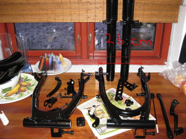

I have a XT500 1980 and I bought this swingarm on Ebay (the right one in the picture, the left one is the original).
It is 260 mm wide. The XT500 axle is too short. Do anyone have an idea which rear axle I can use for that swingarm ? I have looked at an axle for the XT 600 Ténéré, but I was told it is 320 mm long. Much too long. And I was further told it isn't possible to shorten it without destroying it.
I look forward to hear from you !

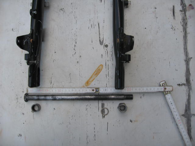

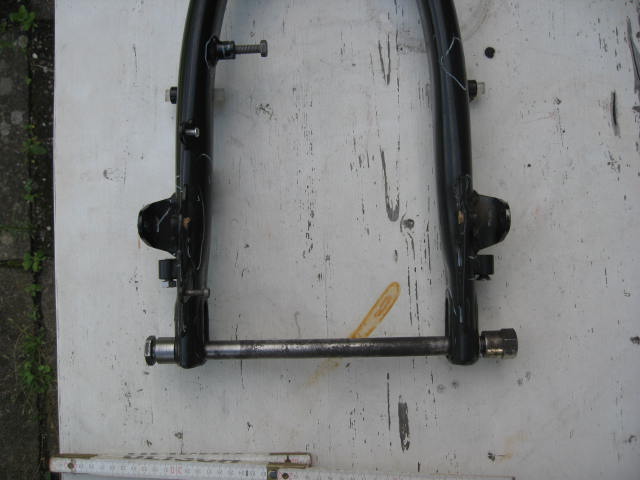

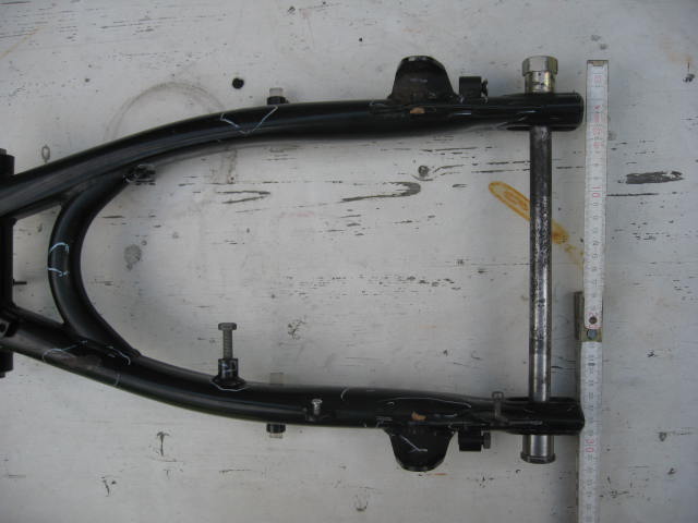

here my solution without original malossi axle: Its an axle of the XT600 Tenere ´84-´85, 31cm long.
On the left side i took a bush and on the right side i took the original Malossi nut.
On the right You can take also a second bush and an normal axle nut.
Schönen Gruß
Andreas

the bushing is handmade by a spezialist (a Dreher)
But You can also take a piece of a metal tube
Andreas
