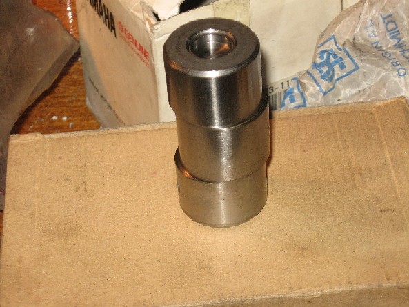

Appelflap
Beiträge: 18
Registriert: Do Okt 26, 2006 17:32
Beitragvon Appelflap » So Dez 03, 2006 22:32
This one ?
pointer
Beiträge: 918
Beitragvon pointer » So Dez 03, 2006 23:23
@appelflap: I'm sure he means that one - well, maybe not the eccentric model in particular, but is there a difference in the bore (the one that feeds the rod with oil) between that one and the standard pivot?
