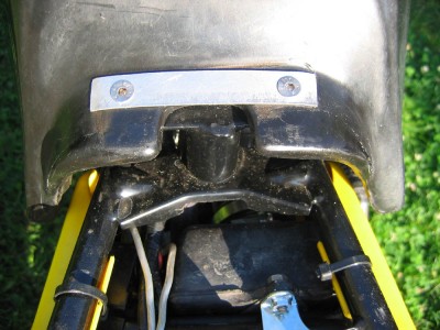

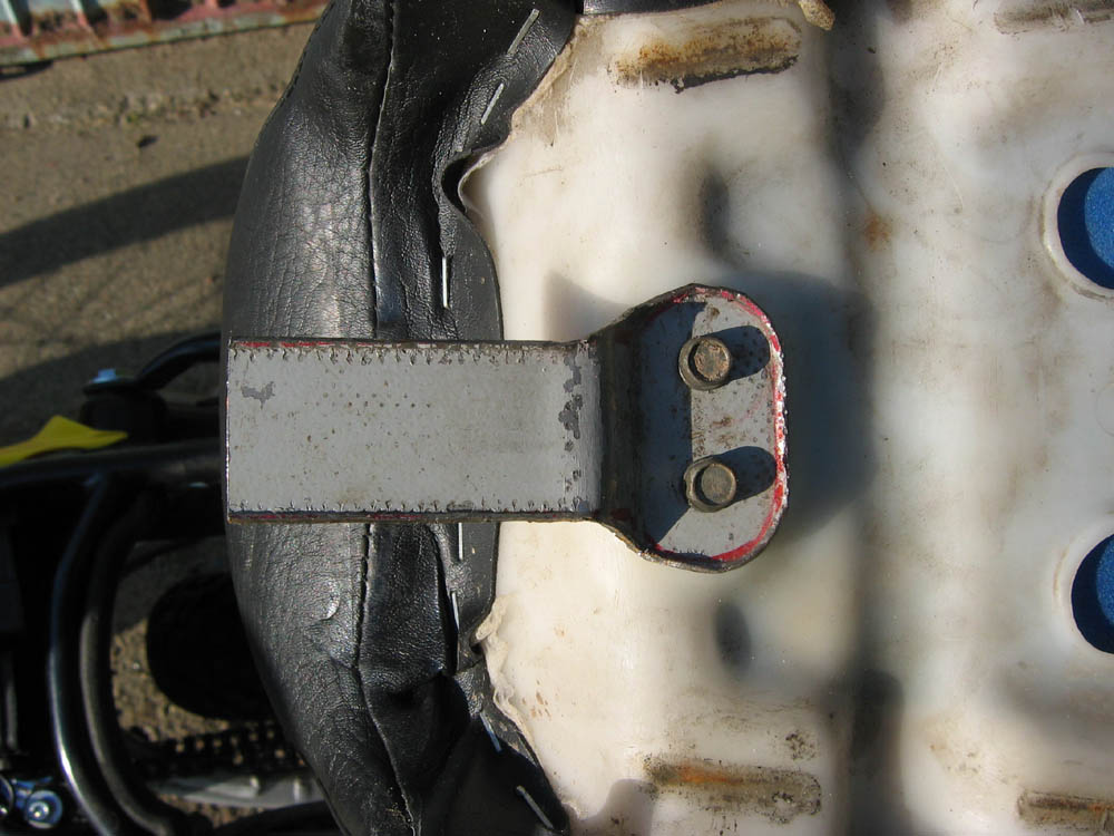

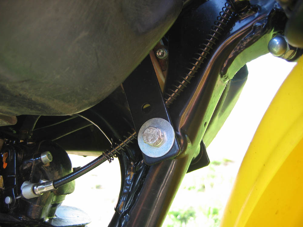

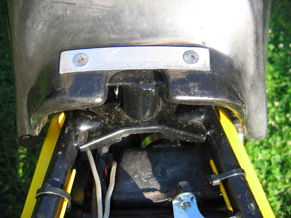

I did the same like you want to do. My XT for the EnduRoMania is 1977.
So I put the Acerbis on the frame and took, like hobbes said, a seat from the 1980th.
Then you just have to build yourself a longer steel plate for the front of the seat.
The original is too short. I'll take some pictures for you!
In my case someone else had the Acerbis on an early XT before and he
allready changed the back holder of that gas tank.
Hard to describe, I'll take pictures too!

Hi Marcel,
here are the pictures!
Greetings - XTom
Greetings - XTom
