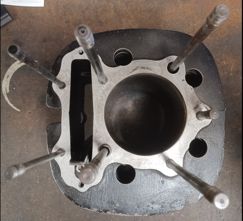

here are two Rayer and a JPX (in the middle)
the foundries are totally different.

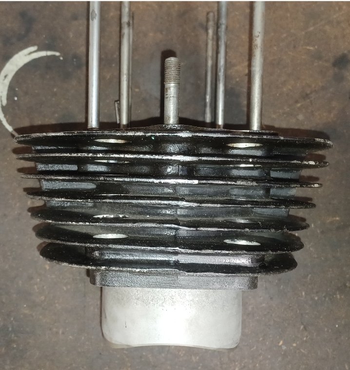

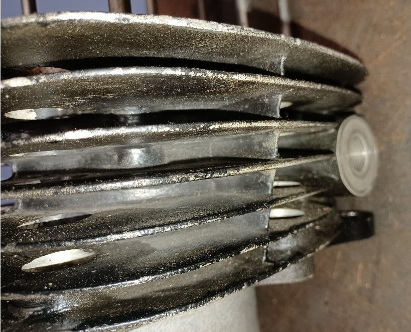

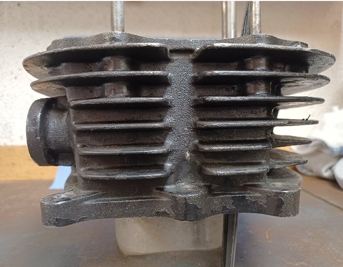

...here some more pictures of the Nikasil JPX:
Pablo
Beiträge: 27
Registriert: So Jan 15, 2023 18:04
Re: Pro tec 600er HL
Beitragvon Pablo » Do Jan 19, 2023 18:55
Yes it look very similar...

Beitragvon Pablo » Do Jan 19, 2023 19:44
we do not see well on the photo if it is a shirt reported or if it is in one piece.
and there is no fin reinforcement on the spark plug side.

Beitragvon Pablo » Fr Jan 20, 2023 9:44
Hi,
Can you measure the inner and outer diameter of the sleeve?
in fact it is very likely that it is a 3DM, painted black...
Beiträge: 2596
Beitragvon Mambu » Fr Jan 20, 2023 21:04
Hi again,
the shirt has an outer Diameter of 103 mm and a length of 52 mm from the bottom surface. As the former owner of the motor told me, the bore was original 93 mm, but was increased by Kedo / Grossewächter to now 95 mm.
As I have two 3BM Cylinders here, I can definitively say, that it is non of these cylinders.
