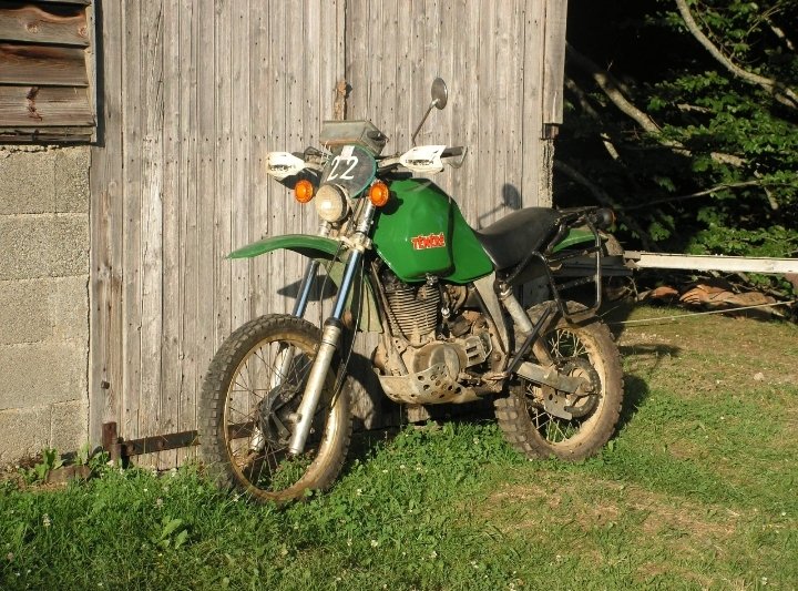

Thanks !
Yes, I love this green paint of the tank. And I ve use John deere green paint for the fenders, it s really almost the same!!
Re: Auf der Suche nach der Handlichkeit...
Verfasst: Mi Mär 01, 2023 16:48
von Pablo
Here almost finished and in Dakar version...

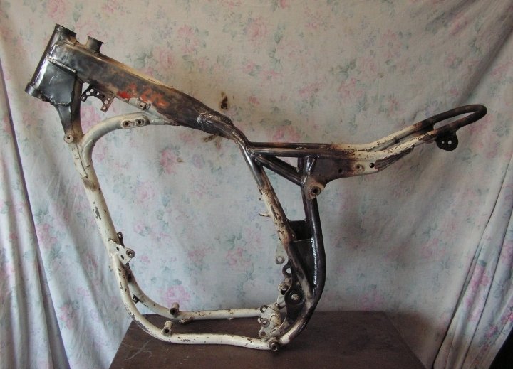

von Pablo
And the frame just welded...

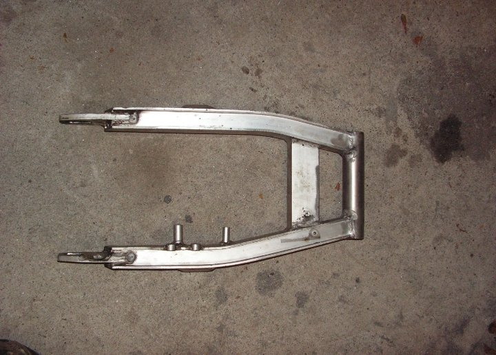

Did you lower the swing arm pivot in the frame? It looks as if your swing arm is quite steep. I guess that works well for you anyway? Also what kind of swing arm ist that? Suzuki? Looks modified too.
Verfasst: Do Mär 02, 2023 14:03
von Pablo
Hi.
morning.
no I did not modify the anchoring of the oscillating arm. it is certainly better, but my level of piloting is very happy without it!
It is indeed a Suzuki swing arm, PE 250 from memory. shortens.....

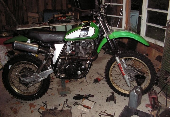

This is my current XT, which I bought 12 years ago. I ride it in this condition since 9 years.
No frame mods though:

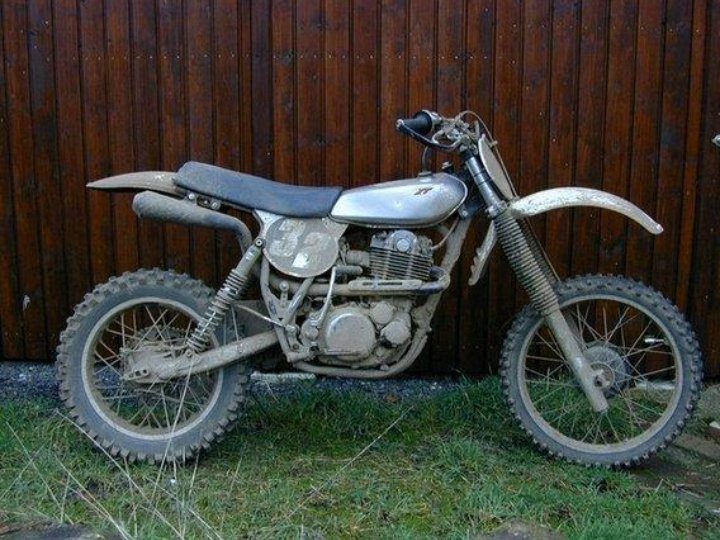

one of the motorcycles that inspired me.... I realize that it strongly resembles the one at the beginning of the post.....!
and some measuring frames with the horizontal underseat tube as a reference.
Original
Barigo
Bye
