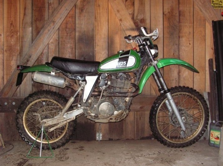

Yes, I love this green paint of the tank. And I ve use John deere green paint for the fenders, it s really almost the same!!

Here almost finished and in Dakar version...

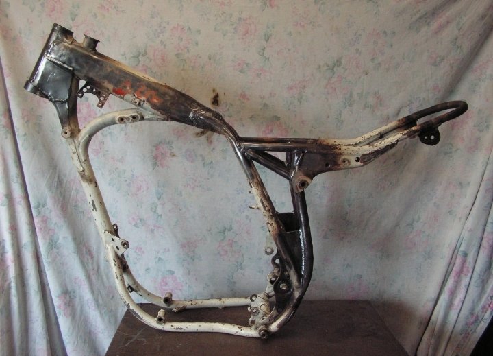

And the frame just welded...

Hi Paplo, I also like green
nice bike!
Did you lower the swing arm pivot in the frame? It looks as if your swing arm is quite steep. I guess that works well for you anyway? Also what kind of swing arm ist that? Suzuki? Looks modified too.

Hi.
morning.
no I did not modify the anchoring of the oscillating arm. it is certainly better, but my level of piloting is very happy without it!
It is indeed a Suzuki swing arm, PE 250 from memory. shortens.....
morning.

Good job, Pablo!
In my early XT-days I built a swingarm (no mods on the frame) which looked as steep as yours. I had huge problems with traction, because the rear suspension stiffened while accelleration. Maybe yours works well because you use other dampers?

Ah yes. I haven t this problem. Maybe because I ve modified the frame and the high anchoring of damper To keep them near To a 45° inclination.... with 400mm long damper...
Maybe yours are too vertical.....

one of the motorcycles that inspired me.... I realize that it strongly resembles the one at the beginning of the post.....!
and some measuring frames with the horizontal underseat tube as a reference.
Original Barigo Bye
Original Barigo Bye
- Beiträge: 7140
Re: Auf der Suche nach der Handlichkeit...
it is the same motorcycle, in an earlier rebuild state.
